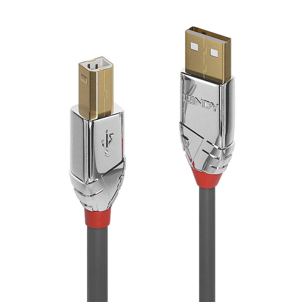

If you need a USB 2 cable, then look for a USB 2 cable (with Type A and Type B plug).
You need something like this, up to 5 m is possible according to the standard, this is a 3 m cable:
https://www.lindy.de/3m-USB-2-0-Typ-A-a … ;ci=800501
https://www.lindy.de/$WS/ld0101/websale8_shop-ld0101/produkte/medien/bilder/gross/36643_1.png
