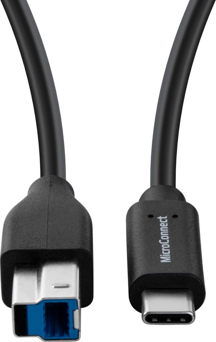

Yes USB connection is the way to go, Thunderbolt is history.
Did you even try to connect the interface thru USB ?
In our Swiss online shop (we don't have amazon, but it should not be a problem to find this cable ) :
https://www.digitec.ch/de/s1/product/mi … l-21460632
No need for any adapters anymore
This cable often is simply called printer cable, look for USB 3.0
https://www.digitec.ch/im/productimages/2/3/8/6/6/1/5/7/9/0/9/3/6/4/1/0/8/8/0/ee2406b6-7a34-4b9d-a250-4249cd259be2_cropped.jpg?impolicy=product&resizeWidth=2880

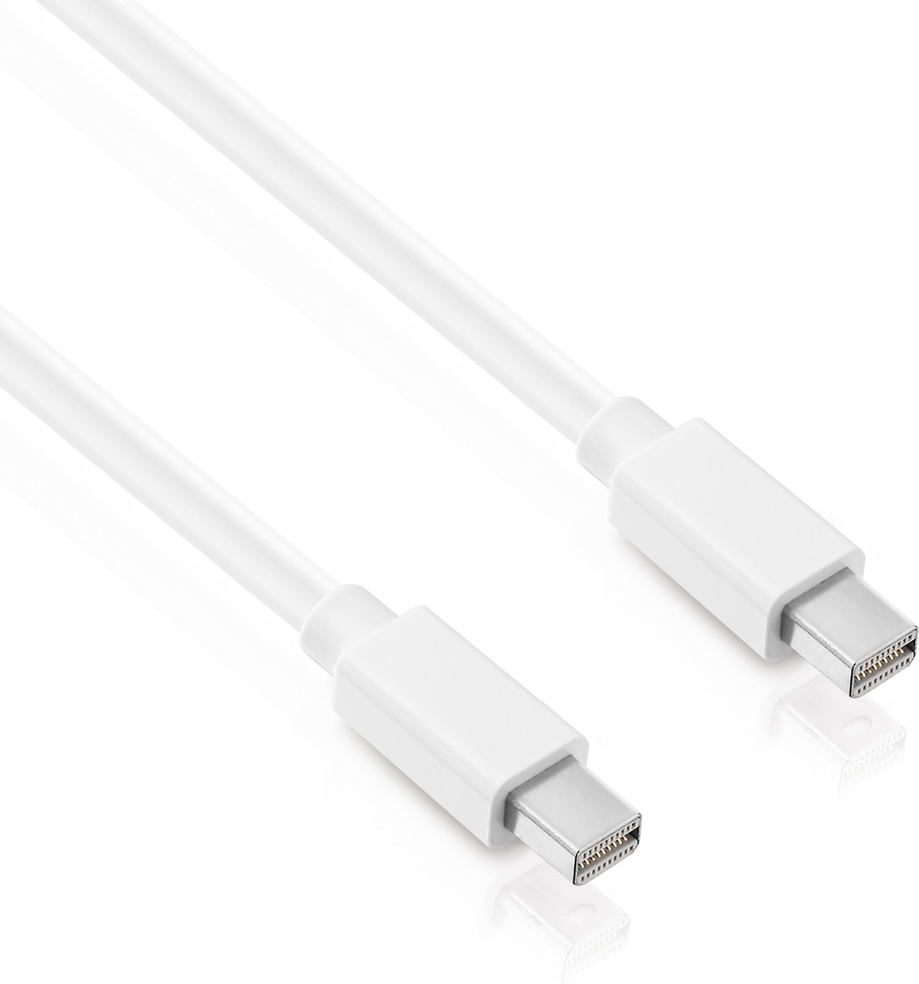

I would try this :
https://www.digitec.ch/de/s1/product/pu … el-5655801
It is just a cable with two identical connectors.
There is no need to edit a protocol as your adapter has already the right protocol,
M1-Sequoia, Madiface Pro, Digiface USB, Babyface silver and blue

Is this Thunderbolt 2 connector the same as Mini-Display-connector ?
May you find the cable easier when use this words.
https://www.amazon.com/Displayport-Answ … NGMHJ?th=1
https://m.media-amazon.com/images/I/41OSlNqGmVL._AC_.jpg
This is not a Thunderbolt cable. It's a Type-C to mini-DP monitor cable, to be used with Type-C outputs that support DisplayPort alt mode to connect to a display. It will not work as a TB3 to TB2 adapter.
Fireface UCX II + ARC USB > ADI-2 Pro FS R BE > Neumann KH 750 DSP + MA 1 > KH 120 A
23 (edited by waedi 2024-10-14 12:10:45)
Re: Still drop outs
Requested is a cable from Thunderbolt adapter to the thunderbolt port of the interface, right ?
Thunderbolt2 to Thunderbolt2 no need for protocol change.
https://www.digitec.ch/im/productimages/2/0/2/1/1/0/0/8/7/5/1/8/2/6/9/3/1/5/6/486a47ad-1832-43f4-9079-03e37014aeef_cropped.jpg?impolicy=product&resizeWidth=2880
Re: Still drop outs
Again, a Thunderbolt cable is active (in the sense they have electronics to make a handshake between the host, the cable, and the connected device; they not necessarily have signal amplifiers) and must support the protocol, that's why they are significantly more expensive compared to regular miniDP or USB-C cables. The cable you linked before is strictly for connecting displays to DisplayPort-enabled Type-C port, which does not require an active cable. The description on Amazon page even specifically mentions this.
The white mDP-mDP cable you link here from the digitec.ch site will also not work as a TB cable due to it being passive.
In short, I would not bother with TB for connecting an audio interface when I can use USB, which is simpler, cheaper, more reliable in practice, and is a much more flexible connection.
