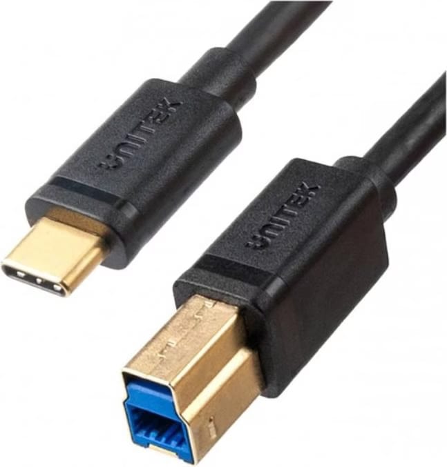

If you order one : USB 3 cable with connectors USB-B to USB-C
https://www.digitec.ch/im/productimages/5/1/4/1/6/7/1/8/3/8/4/6/9/8/9/7/9/5/7/a5e64c45-8a99-4c0c-8683-cee708b917fd_cropped.jpg?impolicy=product&resizeWidth=2880
https://www.digitec.ch/de/s1/product/un … l-32047694

The Digiface USB is a USB-2 interface, the cable from the photo above will work on every computer with USB-C connector.

Answer is: maybe. Some USB cables are really bad in quality. It is impossible to tell from looking at the picture or even referencing specific cables on Amazon. If it is according to spec then it should work without a problem, especially if it is not very long (ie. not longer than one meter). You can inspect CRC error counters in the driver dialog to find out if there are issues with the cable. I am using a cheap (ie. less than 10 USD) cable similar to the one waedi shows and it works without any issues.
