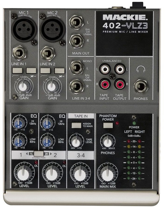

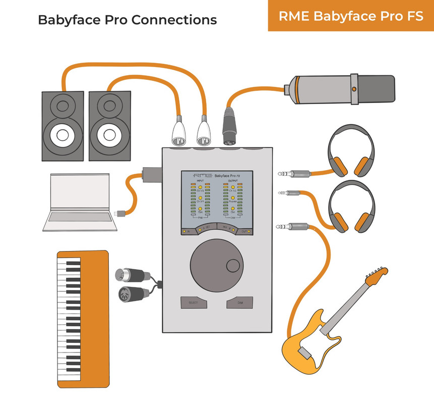

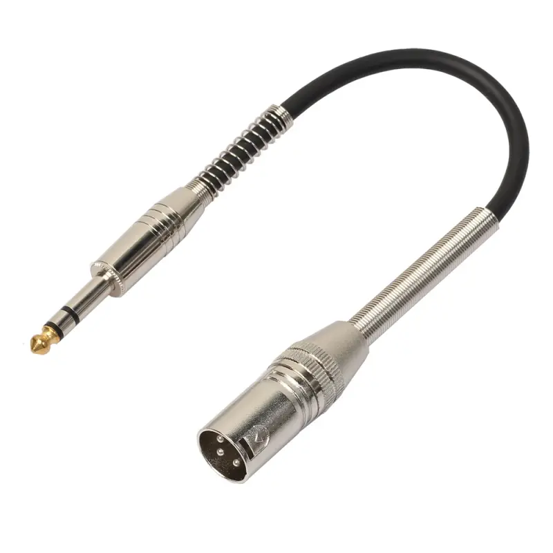

1,316 (edited by sikorsky 2024-07-30 22:20:50)
Re: The official Babyface Pro Thread
Hi. I just got RME Babyface Pro and try to connect it to my Mackie 402-VLZ3 mixer.
I found in the net these pictures attached below. So, I figured that I need to buy two cables also attached on the picture below. I bougth that cables, tried to connect my card to mixer and... no signal in mixer. XLR connected to card, tried to connect jacks to mixer in line 1-2, 3-4 - no signal. Am I wrong with these cables? Please, explain me what cables I must use for connect my card to this mixer. Thanks
https://i.postimg.cc/VLZRwRqN/Whats-App-Image-2024-07-15-at-00-51-56.jpg
https://i.postimg.cc/YqC3TVmV/Whats-App-Image-2024-07-15-at-00-51-56-1.jpg
https://i.postimg.cc/85yFvyPJ/Sc0c73d096f7a4f5297c15adb2743e3f1l-1.webp
1,317
I found in the net these pictures attached below…
Hi! The drawing is not correct! When you have the Babyface pro in front of you, the two 'female' XLR connectors on top left are microphone inputs. The two 'male' connectors on the right are the main outputs. To connect the interface output to Mackie line input, you’ll need cables with XLR female and 6.35mm plugs.
UCX - FF 400 - Babyface pro - Digiface USB - ADI-2 (original)
Mac mini M1 - Macbook pro - iPad Air2
I see no need for that particular mixer as it’s not really adding anything. TotalMix is more flexible.

1,320
I would add, that mic cable on that drawing is also wrong. Male XLR should go to BF Pro, not female XLR. (And of course to the sockets on top left, not top right).
… this, and even the MIDI breakout cable is wrong drawed as well as the placement of headphones outputs and instrument input.
oli77sch wrote:
Hi! Thank you very much! I bougth female connectors and changed purchased cables from MALE to FEMALE, i.e. gender transaction LOL. So, all works perfect now!
https://i.postimg.cc/6Tgz0whg/Whats-App-Image-2024-08-01-at-18-37-15.jpg
