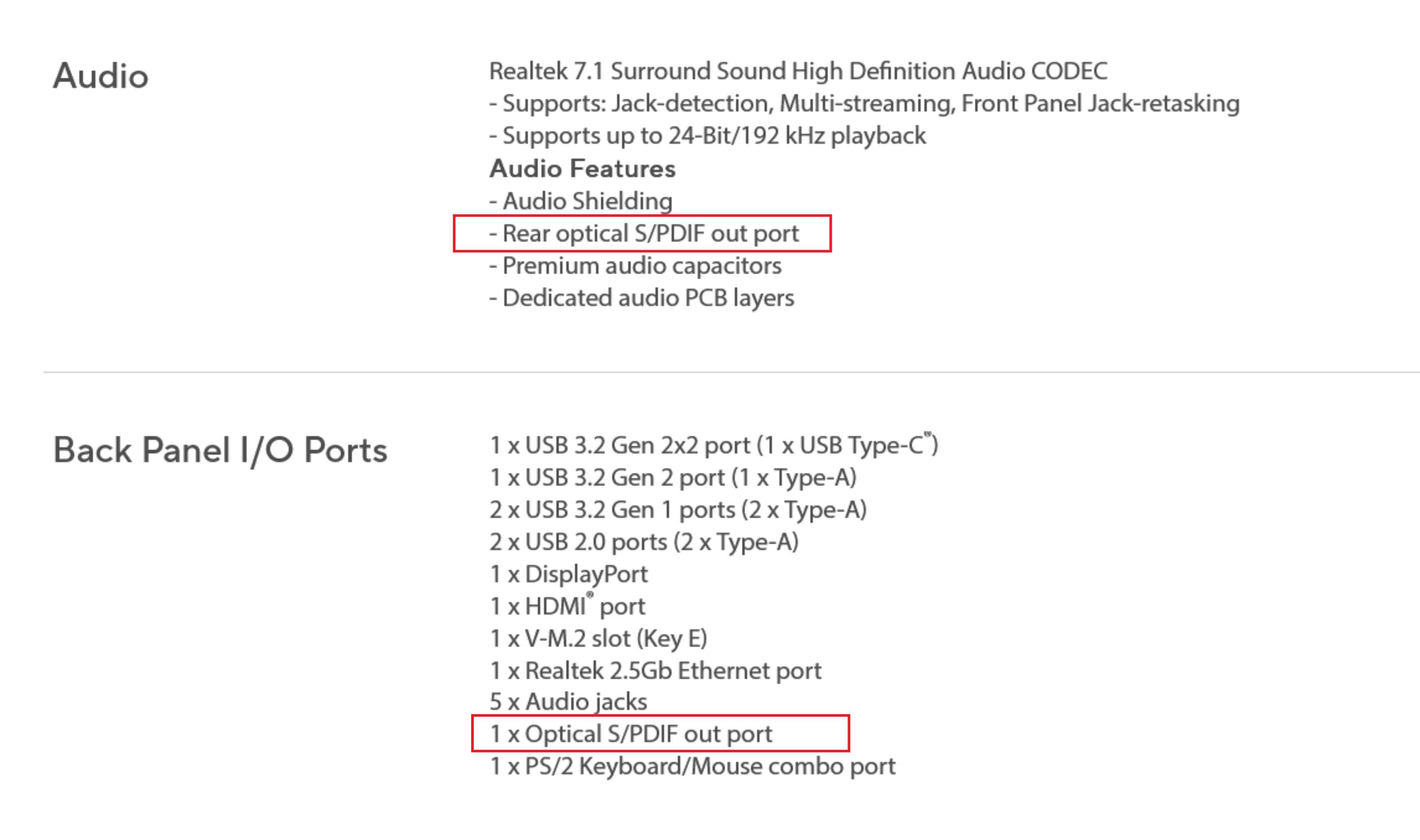

Re: ADI 2 DAC FS / 2 computers
Axmax wrote:
Can you please share a link?
For the 1st motherboard:
https://www.asus.com/motherboards-compo … /techspec/
http://www.rawac.de/bilder/RME/SPDIF_Port.jpg
The information is very similar for the 2nd motherboard.
Ralf
https://i.ibb.co/vz3K213/optical.jpg
